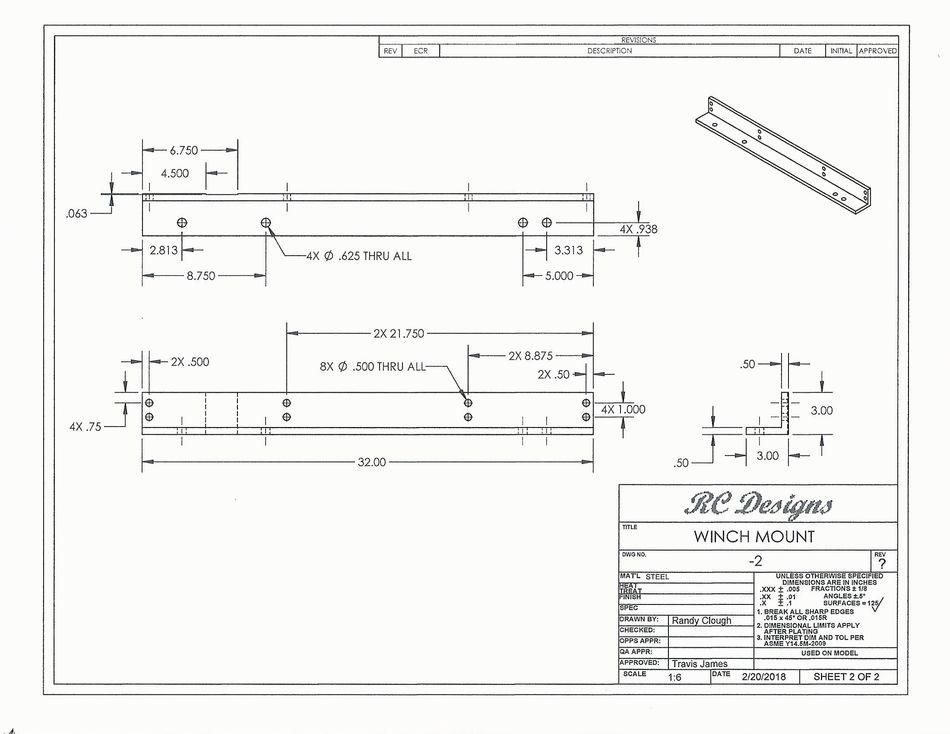

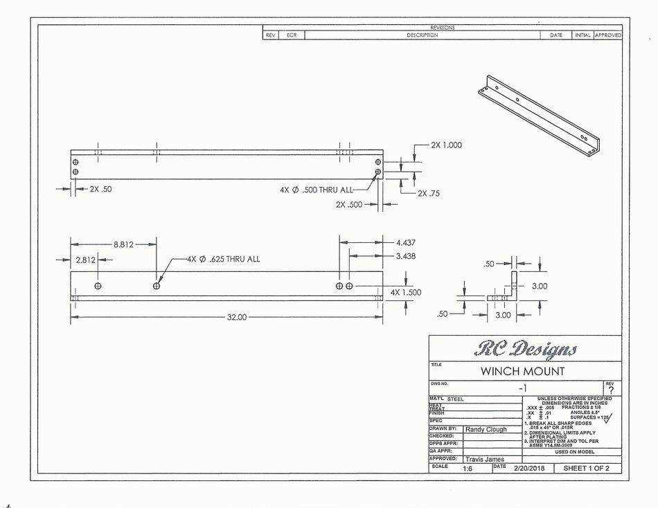

Hi Guys,
I had to do some work on my winch recently so I ended up taking it apart. I ended up making a set of winch rails for someone and at the same time paid to have the rails drawn out.
I'm posting these for free but if you want to chip in a few dollars that would be appreciated. I might do more of this, getting drawings made, if there is an interest.

I’ve been making some replacement rails for my winch (some of the many missing parts) and noticed what I think are some errors in the dimensions.
On the front rail, the distance between 5/8 holes for the drive housing should be 6”, the same as the rear rail. They should also be 1.5” from the top (or bottom) edge, the same as the rear rail.
Lastly, the non drive end bracket 5/8 holes, I assume to be out but I’m not sure which drawing would be incorrect. I don’t have that bracket so can’t confirm, but all the photos I’ve seen suggest the hole distances are the same for the front and rear rail.

December 30, 2021, 03:32:29 AM »
Could the guy who did the drawings have made a few mistakes? The front rail drawing definitely has issues, with the drive housing holes drilled as indicated, the housing won’t even raise high enough to fit and the distance between holes isn’t enough. The rear rail is spot on for the drive housing and I assume the dimensions would be the same for both front and rear. I’ll see if I can get some photos with my drive housing fitted.
Please don’t think I’m knocking the drawings as I’d be no where without them.

I’ve got some photos, hopefully this will explain better.
First is my front rail with holes at .938” from top as per drawing, second is an original rail. The bolt heads are much closer to the bottom edge and I’d estimate at 1.5” (or centre to rail depth).
Next photo is 2 x 5/8” bolts 1” apart as per the drawing of the rear rail for the non drive end bracket. The heads are so close you can’t get a socket on them. Next is a photo of an original rail where the bolts are further apart and I’d guess the distance of 1.687” shown on the front rail drawing is correct.
