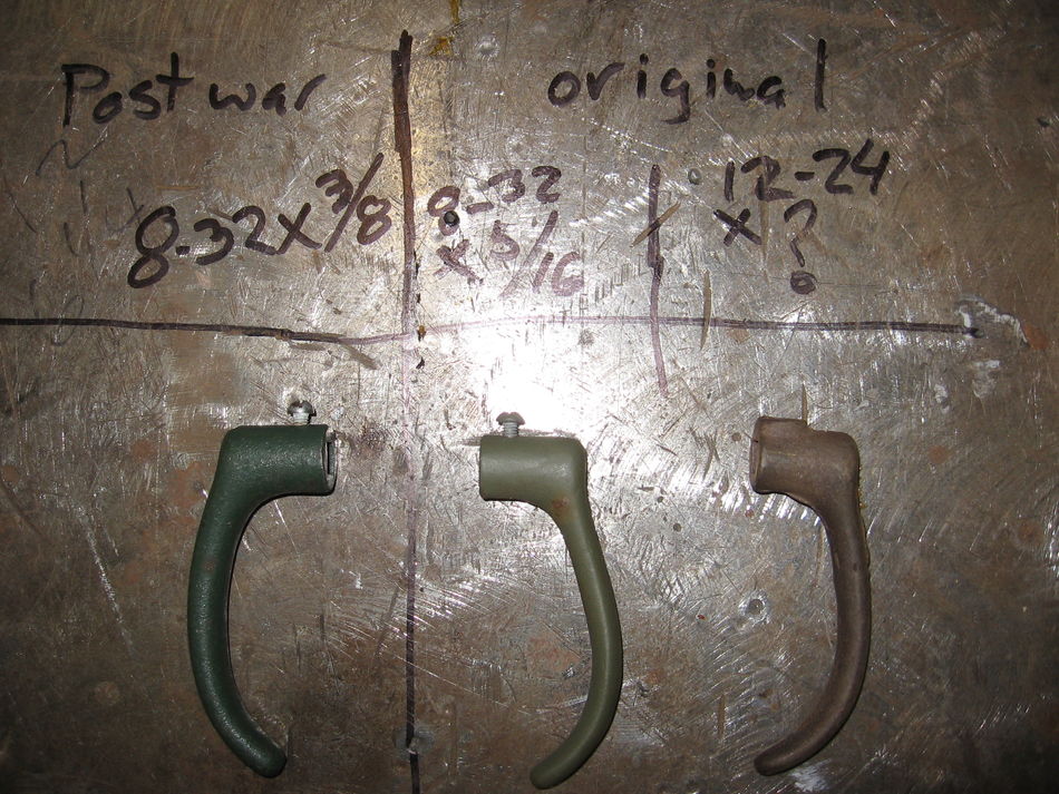

Hi all,
A quick question: I'm after the screw size for the inner door handles on the scout car and half tracks. I'm pretty sure they are the same for both.
I have two inner handles here but no screws and I can't find anything in my collection of bits and pieces that will fit the thread.
Can anybody advise please?
Thanks.

i depends on which handle you have.
here are 3 original handles.
the first (greenest) handle i believe is post war. i purchased this from Yamulla Enterprises.
it has a round head slotted screw 8-32x3/8
the second original (green) handle has a round head slotted screw 8-32x5/16
the third handle has a 12-24 thread, i dont know the length.

September 09, 2014, 02:14:31 AM »
Thanks Steve,
It looks like I have the same first two handles that you have there. I got one of them from Dave Yamulla; the other I think came with the vehicle.
I have seen these screws advertised in New Zealand and by the looks of things, these 3/8" ones will do the trick?
http://www.anzor.co.nz/machine-screws/pan-head-slot-machine-screws/832-unc-304-stainless/832unc-x-38-304-pan-slot-mscrew/product
I am not familiar with the 8-32 sizing. Are these deemed to be a UNC thread?
Thanks.

September 09, 2014, 07:48:24 AM »
It is a UNF thread. 24 would be UNC. It is a standard screw and thread pitch in the US.

September 09, 2014, 09:13:52 AM »
the ones in your link are stainless but they should work.
there are lots of these on ebay. use the search terms= 8-32 round head slotted screw

Many thanks for your offer though Don, and I will keep it in mind. I will keep hunting around and see if can find a supplier for the same rubber bulb seal for the windscreen who will ship to NZ. I'm also taking Steve's advice for the slightly longer 10-32 Thread, 3/8" screws with that rubber bulb seal.
I spoke to some local fastener suppliers here and both seemed to think the 8-32 screws were a UNC thread so maybe what we have here is a little different. I'm not sure. My other option is simply to retap the two handles for a metric machine screw. Not ideal, but that might be a little simpler when it is just two screws involved!
