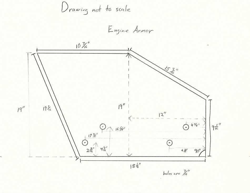

I've been asked to draw this up by several people so here it is, engine side armor drawings. Drawings are not to scale. Measurements are within +/- 1/16". All measurements are taken from the right. Drawing is upside down.
