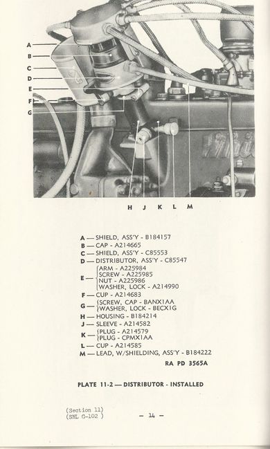

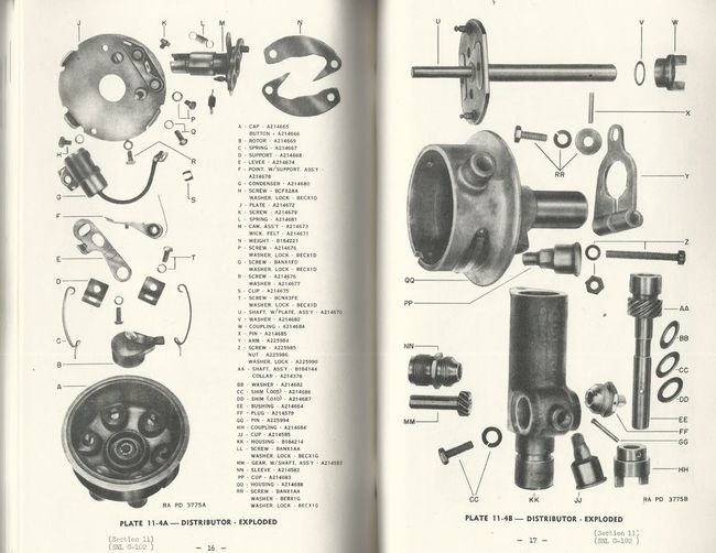

« Reply #2 on: January 26, 2020, 12:27:37 PM »
I had to dig in to my boxed set of manuals for this info. ;D Here are some scans of the early, two piece distributor.

Hi Jon, Vacuum advance was not an option for the White engine. I wish it had one. Usually I see vacuum advance on Chevrolet or GMC 6 cylinder engines. The best way to determine what distributor you have ins the number on the tag. The one, clean, distributor you have should work. If you originally had the two piece one then remove the lower section from the block and the newer one should work just fine.

Thanks Steve, that's what I ended up doing. Just a heads up though,I had to change the end gear on the NOS as it did not fit into the block. I put the gear from the other distributor and now its fits great!
