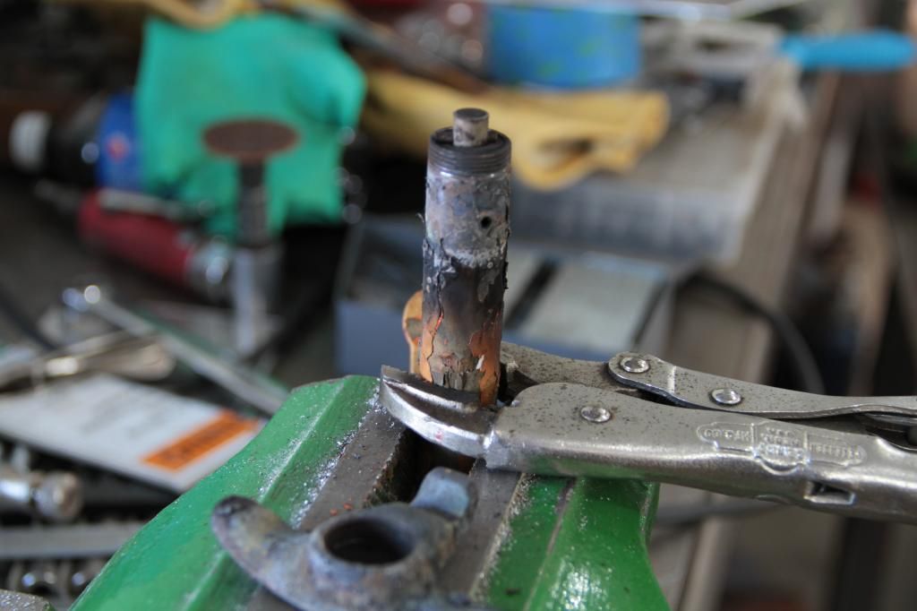

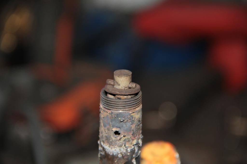

Here is what I did for my hood latches. I took mine apart because some of them were rusted solid or the springs were broken and they were useless anyway. They are very simple and east to fix.
Hope this helps.
Henry
hold it tight, but be careful not to crush the tube. It is pretty thin.

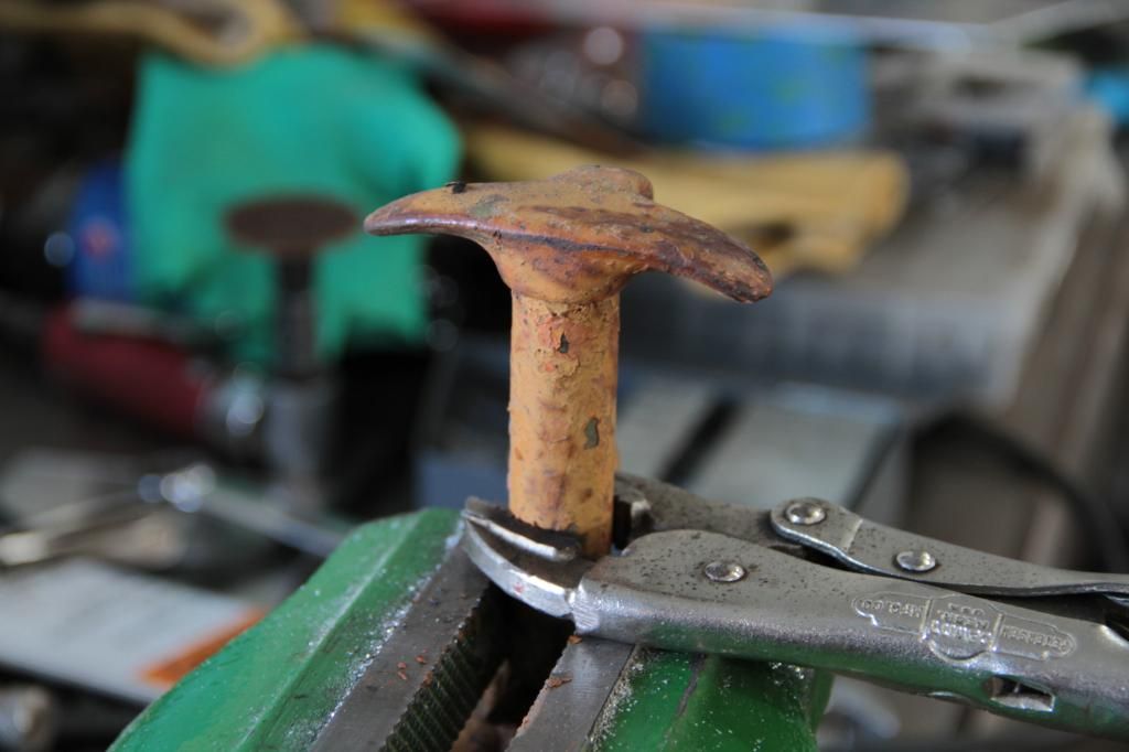

heat it up a little with a torch. it does not need to be glowing red, just enough to loosen things up. I got a little carried away on this one because it was stubborn.
Unscrew the top. Once it moved a little I let it cool down some before continuing so I did not gall the threads.

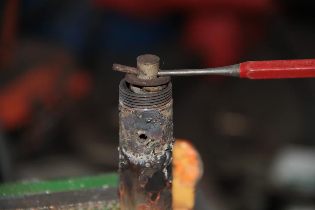

When you get the top off you will see that there is a pin holding a washer over the spring.

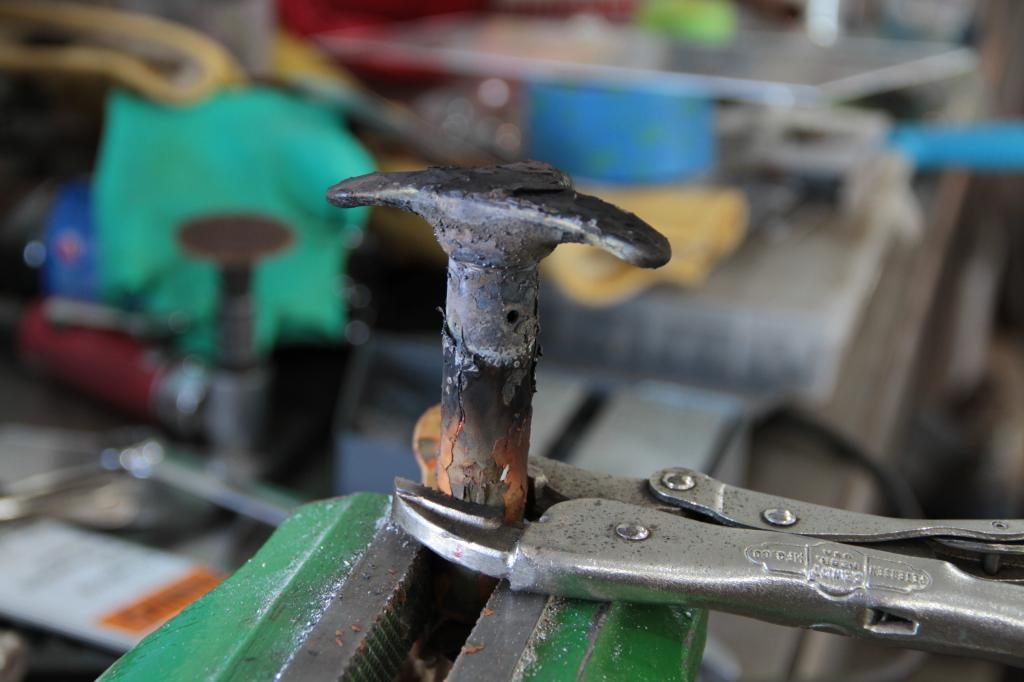

Remove the pin. Be careful the threads are very thin and if you are not careful and hit wrong or too hard you can damage the threads or deform the tube. It is best if you can hold the shaft against a support before pounding on the pin. I wrecked a couple tubes myself, luckily I had spares.

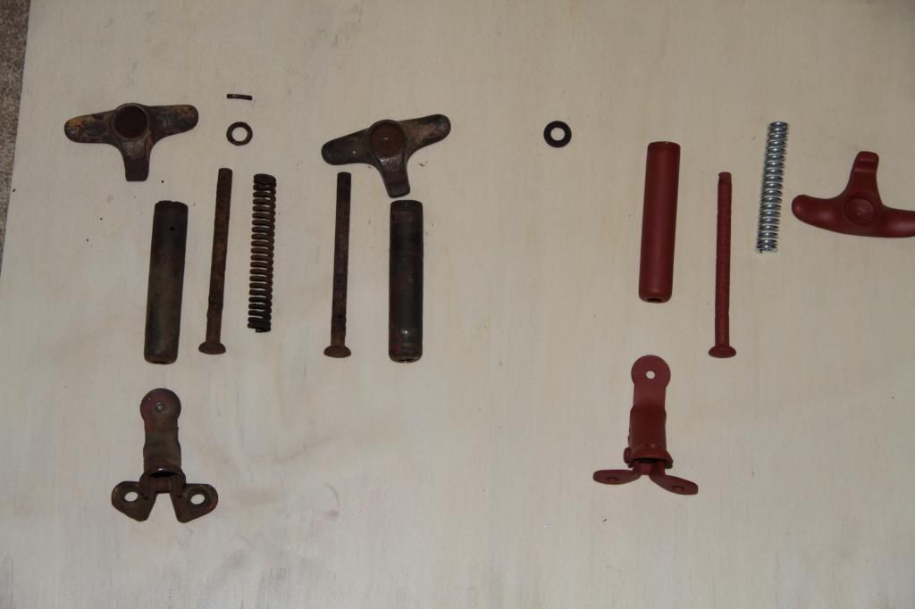

These are all the parts of the latch. I got new springs from the local hardware store. They should also be available from McMaster-carr.
Then sandblasted the parts and ready to reassemble.

Henry
How did you get from pic three, with the pin down in the tube to pic four where it's above the tube so you can punch it out?
Thanks, Jim
  • Posts: 736
Re: Freeing up old hood latches ? ?
« Reply #7 on: July 06, 2015, 07:10:36 PM »
Jim,
I am working on mine now, I had to tap on the post from the bottom with a small hammer and held the tube in my hand. I also used some penetrating oil and heat depending on how stuck each one was. Tapping back and forth got them moving to get the pin out.
« Last Edit: July 06, 2015, 07:12:19 PM by yd328 »
HenryVIII
  • Posts: 176
« Reply #8 on: July 07, 2015, 04:17:47 AM »
Jim, Pretty much like Gary said. I used a small ball peen hammer and tapped on the pin and cylinder. You will knock loose lots of rust and dirt, just keep tapping and twisting and dumping out the loose stuff. Eventually it should get loose enough that you should be able to get at the pin.
