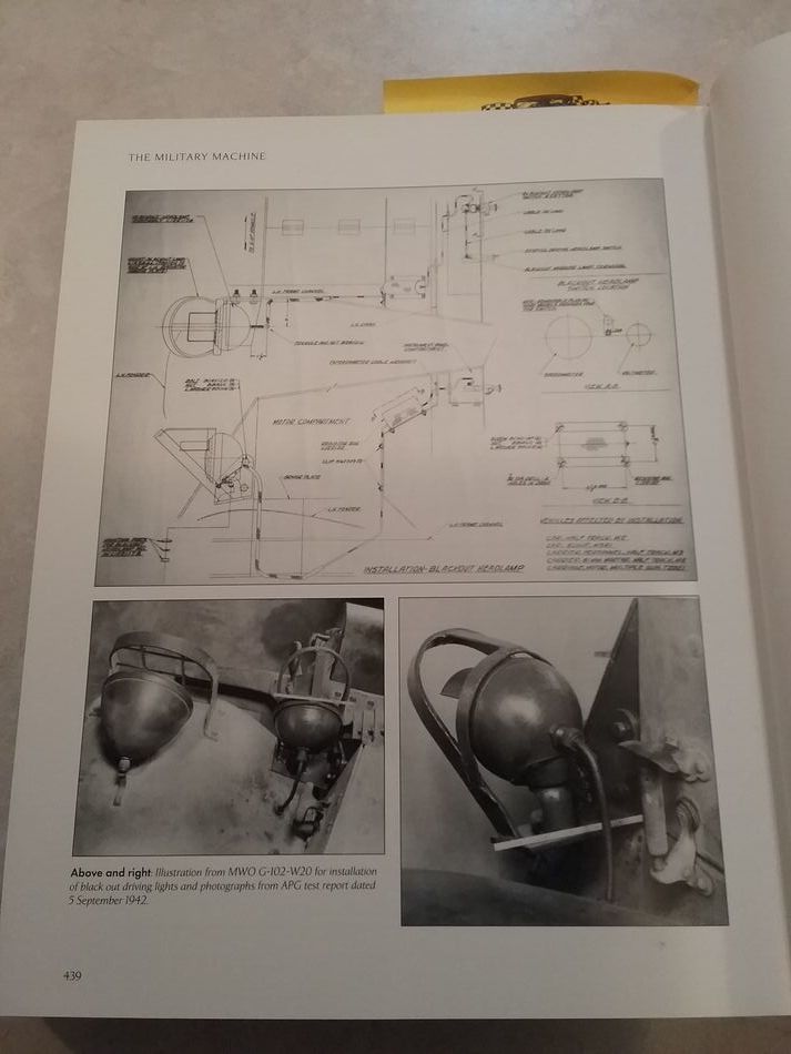

  • Posts: 1424
Re: M2 blackout light
« Reply #3 on: December 03, 2019, 07:44:29 PM »
The black out driving light mounted to the side of the radiator was only implemented on M2 halftracks with fender mounted headlights. This was an add on item. This was not done at the factory from what I can tell. Also, very few M2 halftracks had this item. Most halftracks that were converted to A1 also had the headlights changed unless it was a field mod conversion. The A1 refers to the addition of the pulpit, nothing else. But with that said pedestal lights, mine racks and luggage racks were some other improvements made. I think by the time the A1's debuted shielded ignition had been replaced by resistance ignition and capacitance noise suppression. In the back of David Doyle's volume 1 halftrack book is the wiring diagram for this blackout light.
sorry for the sideways photo.
« Last Edit: December 03, 2019, 07:53:52 PM by steve1973 »
p3aflyer
  • Posts: 95
« Reply #4 on: December 09, 2019, 10:28:56 AM »
That's good info Steve .  Big thank you for that.   Makes sense that a converted m2 to m2a1 wouldn't have it since it would get the pedistal lights.    I am still looking for a war time photo of a straight m2 with the radiator blackout light. Seems rare but looking though photos there were so many ad on and unique things that were done to these vehicles that whatever you want to put on or modify on a halftrack wouldn't be incorrect.    The radiator blackout lighting is one of those cool ad on items.
