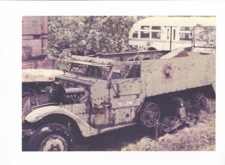

Hi All, here are a few pics of my new project. Came with a rebuilt crate motor never opened until the other day since rebuilt!
Andy

Hey here is a picture of where your drivers door was about 37 years ago LOL.
Re: M2, finally joined the club yay!
« Reply #5 on: May 21, 2011, 06:39:37 PM »
thats amazing  :)

now you are going to have to name your halftrack collene ;D  it looks like there is a picture of collene further back on the halftrack.
does it still have the data plate? it looks like you may have an m2 halftrack that was never converted to an A1. when they converted them they modified the front canvas attachment strip that runs the length of the top section of windshield armor. also if it was converted they would stamp the hood number in the right side bogie wheel cast iron mount. what kind of restoration are you going to do?

LOL, omg the pressure. I just got it friday, and havnt really had to much time to play. So far there was a data plate, but no serial number, but i think ord num was 533. Serial number on frame was 272422, so i assume white? Under the collene, i can see a faint "debbie" The number on the hood mystifies me, i havnt seen anything with ord number starting with 50. I will look for stamp on boogie mount today and report back. I hate to say, but im totally illiterate on these,so a ton of questions comming!

Hey Steve, ok, looked at it. It does have the full length strip across top of windshield, and on the back side of the bogie cast iron mount has the number 5619 stamped 3 times close to each other.
On the data tag, it has 533 stamped for the ordinance number, but cant read serial number, so maybe 533 was ord num when it was m2, and 5619 after refit? or data tag is wrong for mine?

the data plate will tell you if its an m2 or an m2a1. does it say "was m2" on top like this one? this is the most important as it will what model you will be building.

Hey Steve, data plate only says US Army ordinance along the top, no mention of m2 or m2a1. The rest is the same though with speed/rpm etc. Cannot read serial number, ord number is 533

I should also point out it has the early fender lights, and it looks like the fenders have never been off

you could build it as an m2 or an m2a1. the skate rails are about impossible to find for the m2 so most go with the m2a1 that uses a perimeter rail and pulpit.
