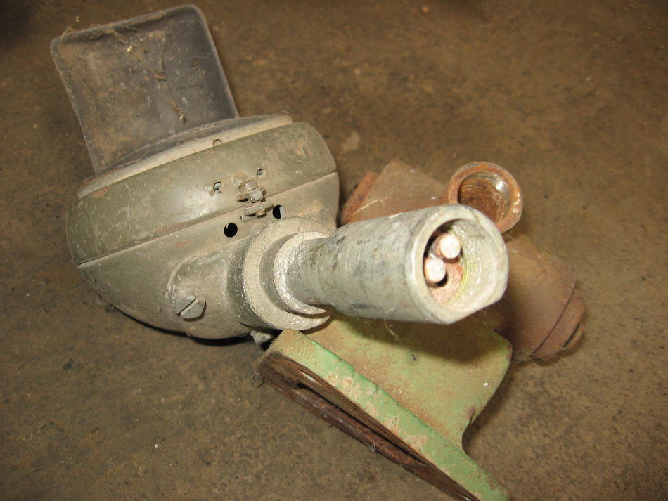

there was a blank that was inserted when the headlight was not in use. i have managed to remove these by tacking a nut to the top and using some all thread to rig up a puller. this has worked well but is of no use to pull the headlights. if they are not stuck to bad you may be able to pull up on the heavy brass flange of the headlight casting though i doubt it will work on most of mine.

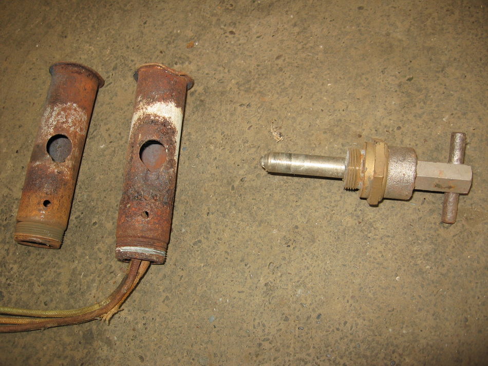

i haven't tried the following but this is what i plan to try. first remove the T handle and brass lock/alignment plug. you should be able to remove the brass plug by taping a few threads into it and pull it with a bolt. if you dont remove the brass plug you can still press the sleeve and headlight through but it will sheer the brass plug and damage the steel sleeve. you can see in the pic that the ones i pulled i didn't remove the brass plug and it damages the alignment hole in the sleeve. with the headlight casting off the vehicle place it upside down in a press and push the steel sleeve protruding out the bottom of the casting. this sleeve bay buckle and you may have to remove all of it with a grinder that is past the bottom of the casting and try pressing it again.

 Thanks for the photos! I have removed the blank plugs with just a few hammer strikes and a brass punch. The T-handle's came out no problem with simply a wrench. Wiring harness nuts at bottom were tight but came off. One was a wrench type nut and the other was a knurled brass nut with no flats for a wrench. The brass plug behind the t-handle is not shown in your photos I had one come right out slightly stuck to the pin on the T-handle. I am sandblasting the inside of the T-handle hole and will try to tap the brass plug 1/2 fine thread to pull it. Then we start on removing headlamps which I am still soaking with PB.

the brass plug behind the T handle has a 1/2" id so you will need to use a 9/16" fine thread as shown in this pic.

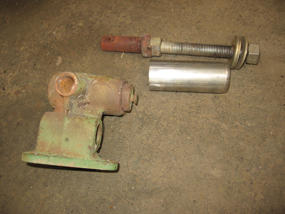

you will not need to do this if there is nothing installed in the headlight socket. simply use a 3/8" x 3" bolt and nut as shown in this pic.
http://www.surfacezero.com/g503/data/3753/medium/IMG_15714.JPG
if it helps, you only need to pull the brass plug out far enough to disengage from the sleeve (about 1/4") then after the sleeve is pulled you can push it forward.
most of the time the brass plugs come out by just pulling on the end of the tap with some vice grips. but if its stuck its easy to make a puller by welding the heads of two 9/16" fine thread bolts together and a short piece of pipe.
http://www.surfacezero.com/g503/data/3753/medium/IMG_15703.JPG
if the steel blank plug is installed in the headlight hole then most of the time it will be stuck to the sleeve so after pulling the brass plug you can punch the blank plug from the bottom (not the bottom of the sleeve but through it to the blank plug) or what i have been doing is weld a nut to the top of the plug and make a puller with all thread and a piece of pipe. i do this if they are really jammed and also because the ones i have done lately have the electrical contacts stuck in the bottom of the sleeve and i want to save them.
http://www.surfacezero.com/g503/data/500/IMG_0308.JPG
to pull the sleeve i use 1/2" all thread and 2" sch 40 pipe 5" long.
the ones i have done also require heat from a rose bud torch.
http://www.surfacezero.com/g503/data/3753/medium/IMG_15694.JPG
the last few i have done have needed the thread chased at the T handle hole. its an odd size... 15/16 x 20 threads per inch.
http://www.surfacezero.com/g503/data/3753/medium/IMG_15505.JPG
