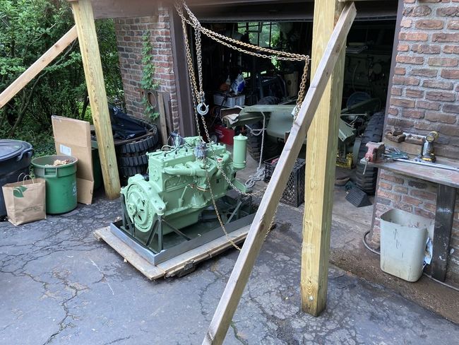

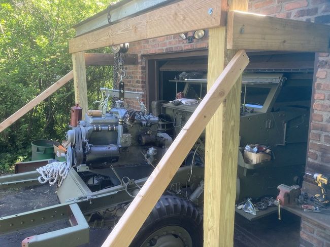

Haven’t gotten a new photo hosting site since photobucket tried to put the scores to me, so just written update. Finally gave up on the old engine and picked up one from sindorf trading in the Netherlands. Really nice piece of kit. Painted it and took the clutch apart so it wouldn’t stick. Installed it and what a world of difference, was able to pull a steady vacum and ran pretty good. After the crb filled up she started on the second try. Installed  the radiator and armor. Tighten the important stuff up and put the old tracks on this weekend. Finally took her out for her first drive on Sunday.had the pit crew and some fire extinguishers along. She ran great and smoothed out 3/4 of the way through the trip around the neighborhood. Ran her for about 20 minutes. First time I was able to drive her since I picked her up 7 1/2 years ago. What a great feeling. Now I have a long punch list of stuff to take care of before she almost done ( their never quite done ever). Also started making my own auto car nuts they aren’t perfect but will pass the 3 foot sniff test. Hopefully I’ll have pics and videos soon, can’t quite figure out the 503 picture site, anyone have a better site for picture and video hosting. Thanks a lot guy for all the help over the years and up to this point and especially Steve for starting this site. Will keep you updated.

Re: More progress
« Reply #74 on: April 18, 2021, 10:36:49 AM »
Haven’t posted in awhile finally figured out how to use 503. Here’s some pics from last summer with the engine I got from sindorf.
