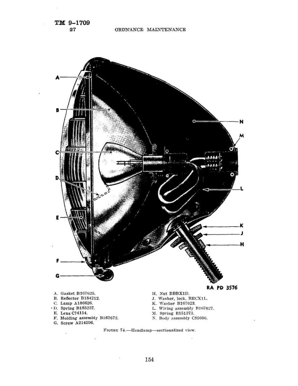

Re: plug connectors for the tail lights and fender mounted headlights
« Reply #2 on: June 08, 2014, 02:22:00 PM »
i could be wrong on this but if i remember correctly.
the front fender mounted headlights use the same 2 pin connector as the left tail light.
http://www.mvspares.com/catalog/product_info.php?cPath=21&products_id=121
then you would just need to get one of these things i think.  ( i dont have any of these headlights anymore so i cant verify)
http://www.ebay.com/itm/X2-FORD-GPW-WILLYS-MB-JEEP-G503-M38-M38A1-M170-WWII-TAIL-HEAD-LAMP-LIGHT-SOCKET-/141281508825?pt=Vintage_Car_Truck_Parts_Accessories&hash=item20e508bdd9&vxp=mtr
these where used on scout cars also
« Last Edit: June 10, 2014, 04:08:32 PM by steve-0 »
  • Posts: 1424
« Reply #3 on: June 10, 2014, 06:19:16 PM »
Steve,
The socket in the headlight bucket is spring loaded and the plug that goes in it is solid. I guess if you use both of the parts you listed it will work but it is reversed from original. The socket is solid and the plug is spring loaded. I can get photos of my originals next time I'm at the shop.
« Reply #4 on: June 11, 2014, 12:07:48 AM »
thanks for the correction
scotty71
  • Guest
« Reply #5 on: June 18, 2014, 10:07:13 PM »
Sockets shown on ebay are produced by Cole Hersee part #2356
