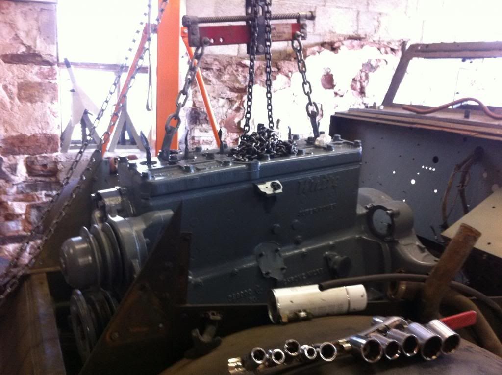

« on: March 31, 2013, 06:05:34 PM »
Finally installed the engine in my track. Thank god my friend Jim had the gantry in his garage.
