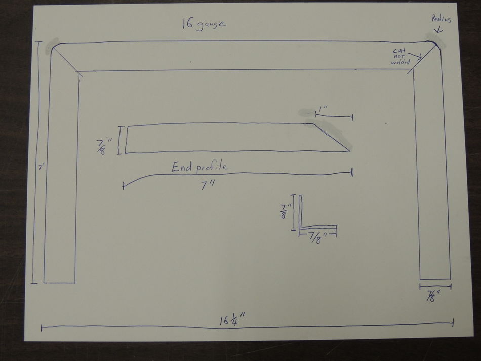

What gauge of steel are the lids made out of ? ? ?    16 ga ??
I am not concerned about the seat cushion placement at this time.
Is there a lip on the lids   1"   ?     1.5"  ?    or is it flat.

I just posted this recently but here it is again. It has all your answers on it.
The thickness is somewhere between 11 and 12 gauge sheet metal. Yes, there is a lip on the hinge side, see drawing. Hope this helps.
