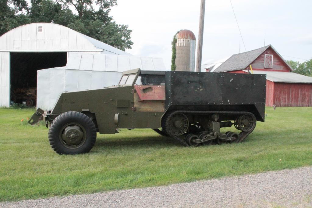

Here are some pictures of the beast. Progress is slow but steady. once I get the mechanical issues figured out I will take the body off and finally paint it. Henry

Nice looking track love the old paint on the doors. Not sure but in the 2nd pic it looks kinda like you have 900x20 size tires mounted. If that is the case don't drive it with those on much or you will damage your front end since it throws off the ratio between the front and rear axles.

Yes the tires are 900-20. I did not think that would be a problem if I did not use 4wd. If this is wrong, I will have to change them to 8.25-20. Good observation. The door is from a halftrack that was used as a tow truck. It says Kulls Garage and the telephone number is 2 (Tel II).

Nice looking track!
Re: clutch
July 22, 2014, 05:06:12 PM »
Nice track Henry

Thanks everyone for the compliments on the track.

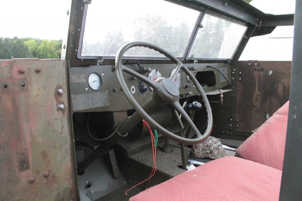

I like you gas pedal. Custom made? looks alot stronger than the flimsy factory one
Andy

yes. Made it myself.. All I did was bend edges a small scrap of left over diamond plate.
Henry
