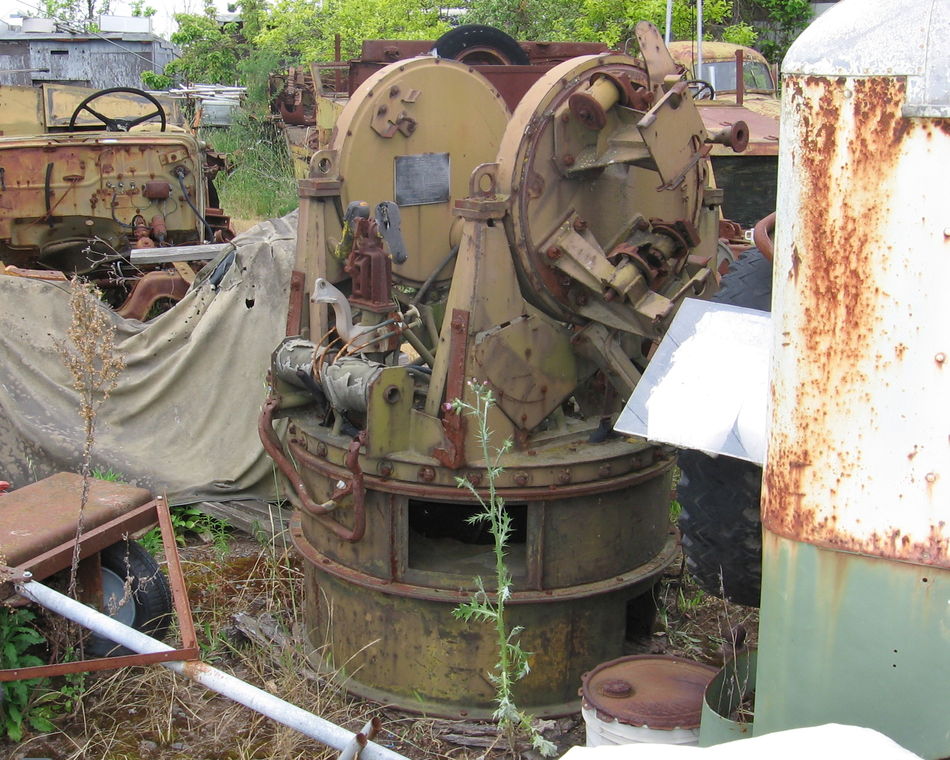

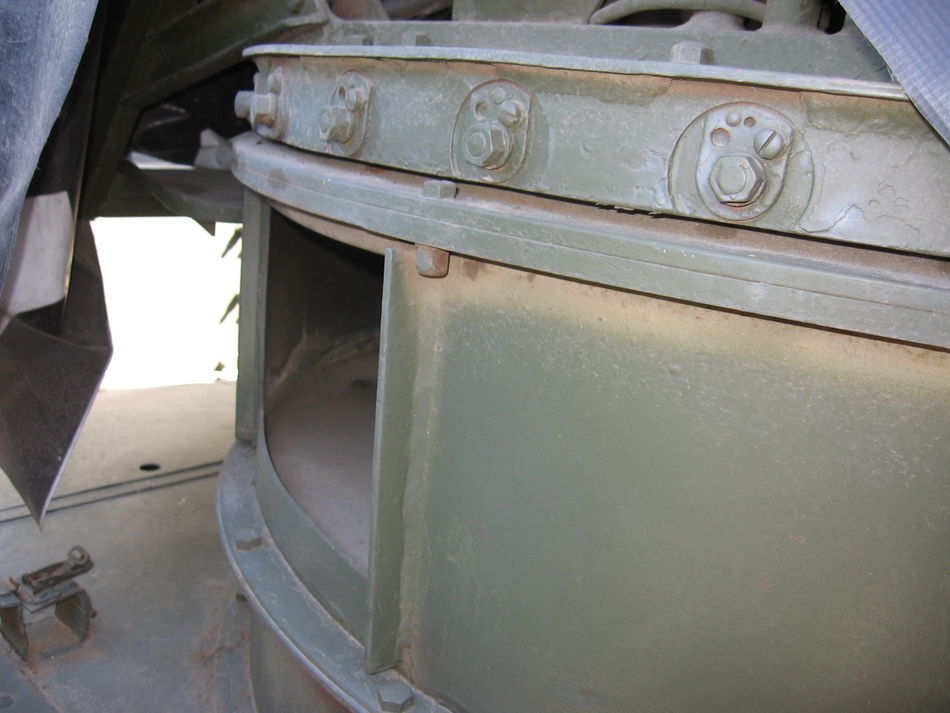

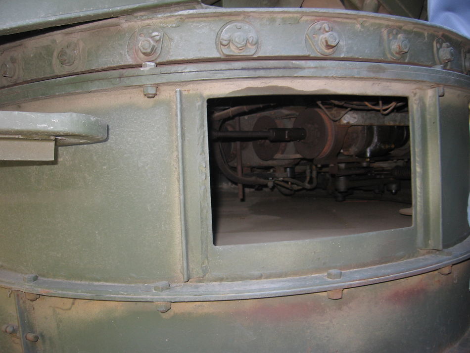

the  M-16 used  10'' and 6'' spacer rings
 the M-16A1 and M-16A2 used 10'' and 12 '' rings
here are some pics of the m16 quad spacers. these are original to the m16
10" and 6"
 these are original to the m16A1 and m16a2
10" and 12"

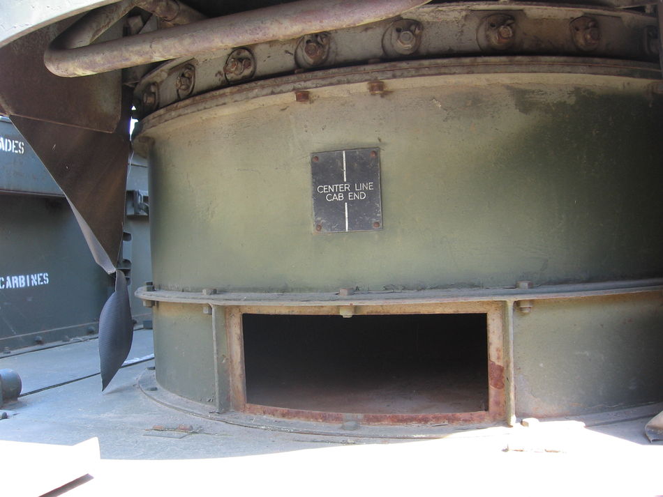

Steve,
Do you know who owns these quads?
I would like to get the size and specs on the "cab end center line" plate on the first one and ask some questions about the "manual" controls" on the second one if at all possible.

there is some info in the Hunnicutt book on page 196-197
  in the pic of the quad it looks like a 10 and 12"
the quad in the top pic is located at Tankland in southern ca
the bottom quad is in earl coltons halftrack in phenix arazona
