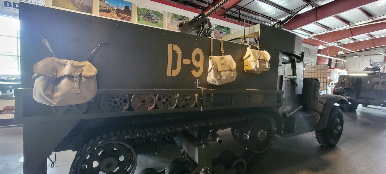

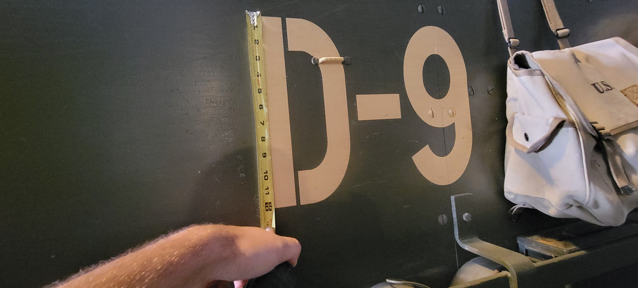

you're definitely not fitting a 20" star on the side of a vehicle equipped with mine racks which tells me that the number in the aforementioned picture isn't 15".
2 of our 4 halftracks are "speed number" marked and they both have 12" markings.

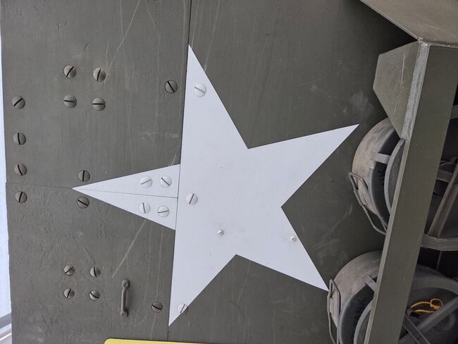

You absolutely can get a 20-inch star on a vehicle with a mine rack. The size of the star is derived from the diameter of the circle that star would fit in, making the actual star smaller than the nominal size of 20 inches. The "20-inch" star on my M2A1 measures 18" from a straight edge across the bottom points to the top point but it would still easily fit if that dimension was 20".

while I humbly stand corrected, and 18" top to bottom measurement is more doable for sure then a 20" which would probably look awkward
