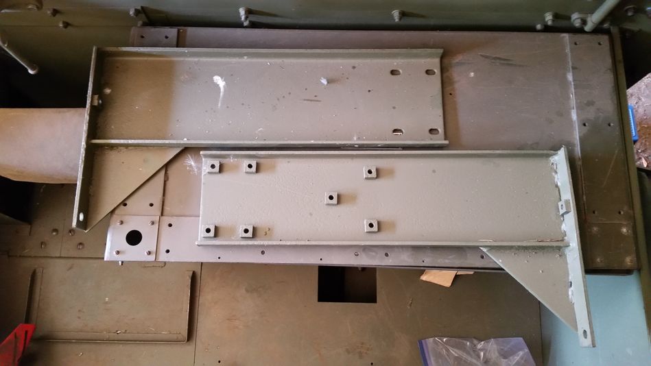

Looking good Gary. Just to let you know the small raised piece with the hole in it in the front locker is for the antenna mast used on M2 halftracks. Antenna mounts are different on M2A1 depending on the radio used. If you plan to install a pulpit you will need the two piece crossmember mount for the rear leg to mount to.
Anybody have a photo of the "two piece crossmember mount" mentioned in the above post?
Keith
1955 M38A1 Jeep
1952 M100 Trailer
1941 M2A1 Half Track
MVPA Member
  • Posts: 736
Re: M2a1 progress
« Reply #185 on: September 09, 2019, 07:43:14 PM »
It is the brace towards the front, bolted together in the center. I can get you some better pictures in a couple days if you need them. There are four bolts in the center and three bolt holes to the right. The three holes are for the pulpit bracing pole.
spillmk1
  • Posts: 293
Re: M2a1 progress
« Reply #186 on: September 09, 2019, 08:05:11 PM »
OK....understand now.
Thank you!!!
Keith
1955 M38A1 Jeep
1952 M100 Trailer
MVPA Member

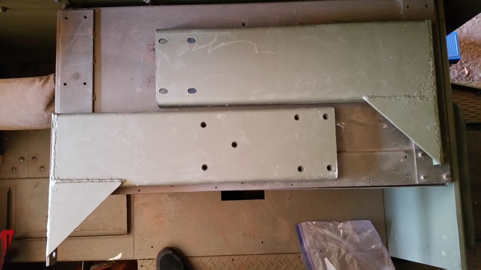

  • Posts: 1418
Re: M2a1 progress
« Reply #187 on: September 11, 2019, 06:04:44 PM »
I finally got a chance to get in my halftrack. Here are the photos of the two pieces.
spillmk1
  • Posts: 293
Re: M2a1 progress
« Reply #188 on: September 12, 2019, 04:46:55 AM »
OK...seeing this it makes even more sense.
The PO bought the floor assembly back around 2005.
It came with a piece I couldn't figure out.
It's a one-piece crossmember but the ends are made exactly like your photo.
Now I know!!!!
Thanks!!
