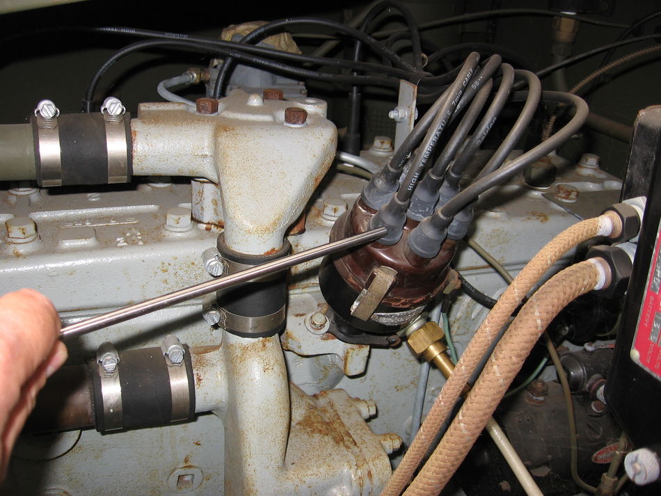

i think you already have this info from the G but for future reference i will post this.
the distributor only goes in one way. for installation you will need a screw driver to line up the oil pump to properly engage into the bottom of the distributer.
pic of #1 cyl spark plug wire.

Re: Distributor and cylinder numbers
« Reply #5 on: March 31, 2013, 06:09:42 PM »
Thanks steve that's exactly what I was looking for.

« Reply #12 on: October 29, 2019, 07:10:59 PM »
Here's a shot of my engine when I was running it on the stand. You can see where my #1 ended up being.
Don't get hung up on the slot.
#1 plug wire doesn't care where it is on the cap as long as the rotor is pointing at it at TDC on #1 cylinder on the compression stroke.
Plug all the ports under the carb for now.
Firing order right?
You have the order going the correct direction around the cap for rotor rotation? Clockwise
Plenty of fuel? These things like a lot of gas.
Keith
