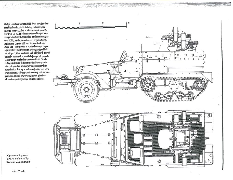

I have a couple Polish books on halftracks. In volume 2 there is a section on the M16B halftrack along with 5 line drawings of the front, rear, each side and top view. I think I saw another post of yours asking about gas tank locations. They are the same M2 tanks but moved forward as in an M3. Their is a rack of four tomb stone ammo cans up front behind driver and center seats, no radio. Here is what the book says on the M16b's.
Before the invasion of Normandy Colonel John B. Medarisa, Chief of Armament of the First United States Army, ordered the reconstruction of Half-Track Car M2 vehicles as self-propelled anti-aircraft guns. Turrets with M2HB machine guns were dismantled from the Machine Gun Trailer M55 and Multiple Machine Gun Trailer Mount M55 units and installed in the cargo compartmants of M2 vehicles using a special ring which compensated for the lack of opening upper parts of the cargo compartment armor plates. The new vehicles were unofficially designated M16B. They were assigned to twenty anti-aircraft battalions previously equipped with towed artillery pieces and were used in combat since the beginning of the Normandy invasion. When the danger of enemy air strikes subsided the vehicles were used to provide fire support to fighting infantry.
I think volume 1 of this set may have some photos of the M16B and will have to check next time I'm at the shop. I currently do not have a scanner to post the line drawings but can take pictures of them to post. I'm also having problems uploading to the G503albums site. I'm at the point that I can't even get one photo to post.
Hope this info helps.

Here are the drawings. Sorry for the delay in getting them posted.

Heres a good pic of a M16B with the side ammo door open, but no fuel tank there? Also if you look at the drawings top view there just doesn't seem to be room for the gun mount to rotate without it hitting the corners of the fuel tanks, The original test vehicle for the M16 was the T1E2 which was an M2 with the quad mount, it had only one fuel tank mounted behind the cab just like the M15....its hard to say just where the fuel tank or tanks were moved too, we may never know.....

to see the photo and the space available, I would tend to say that the tank is positioned as the M15 and on each side two chargers.

I think the overhead shot from the book is a complete guess. My personal opinion is they probably did remove the m2 floor and set up a mount system similar to that in the m16 and then left the skate installed so they would not have to make a new perimeter rail.
