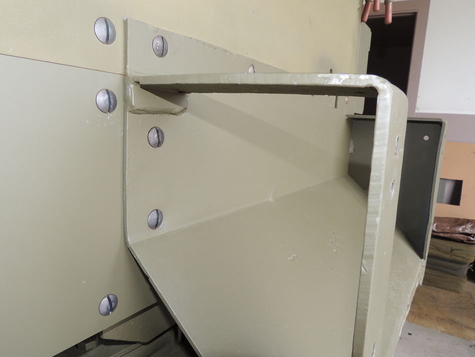

Re: M2 rear bumpers and steps.
Reply #21 on:
May 06, 2014, 10:29:49 PM »
Mine is actually a square piece of stock welded on the end. Here are some photos I had on file before I cleaned them up. I will get measurements and a drawing of this next week.
Reply #26 on:
May 08, 2014, 09:45:17 PM »
I see what you mean about the lip on the "J" bracket but my original looks mor like an "L" with a piece of flat stock welded to the main step piece for support. The part of my "L" bracket that rests on top of that piece even looks like it was notched out a little to make level. Here is a photo. I will get more tomorrow. I think either way will work. Also note, the main bumper piece is 3/16" not 1/4" as indicated on his CAD file. All other parts are 1/4" though. What CAD program are you using? Is it easy to use? I might be interested in getting a program to convert Bob's drawing like you did unless that is something you want to do. I'm in the process of sorting all his files into halftrack, scoutcar, M2HB side plates, M1919 side plates etc.
