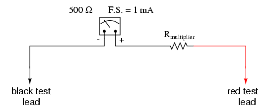

this might make it easier to visualize.
the resistance of the meter is 500 ohms. and it takes 1 milliamp to read full scale. R multiplier is any resistor you put into the circuit that will eat up enough juice ( resistors are like toasters) passing through it so the meter gets what is left .....1 millamp. and will read full scale. this is how you can use the same meter movement to measure even huge voltages, just put a bigger resistor in there.
bud
