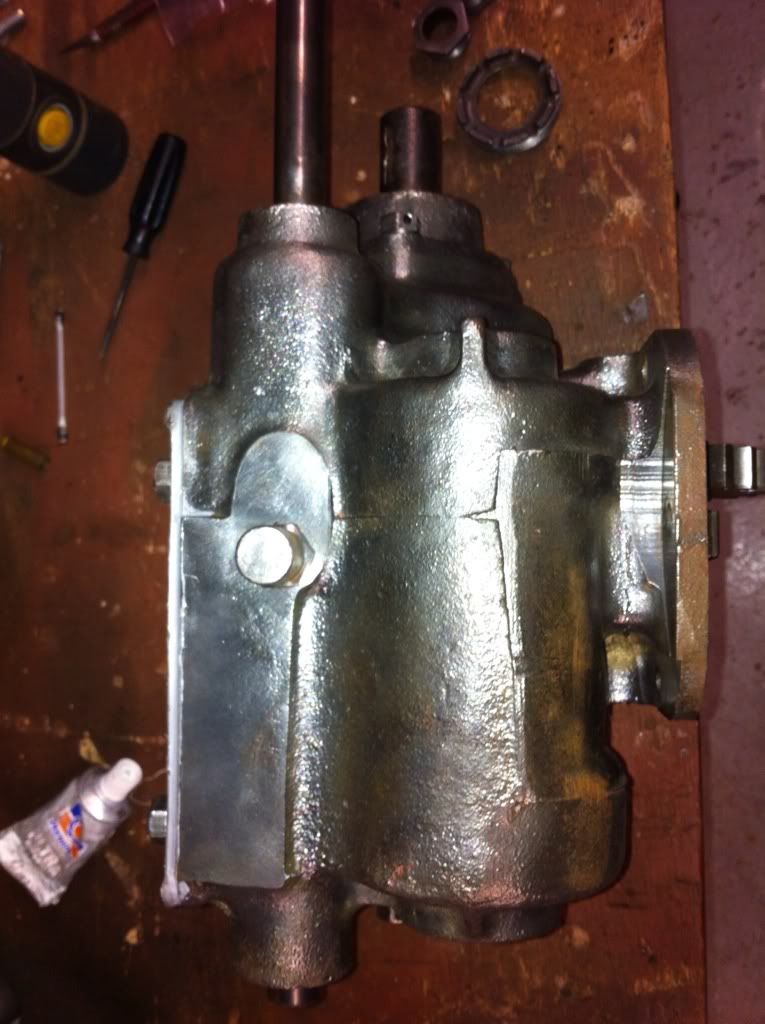

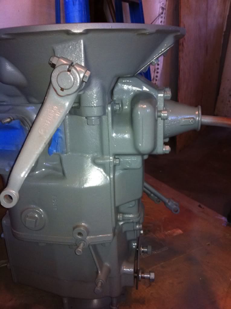

Posted this over at the g too.i,m in the home stretch on the tranny and trans case rebuild and am replacing the seals in my pto. I'm having some difficulty wit the rope seals on the shifting rod.i have been tapping them slowly but can't get all the rope in to each seal. I have been using a brass punch and hammer. Any ideas or tips. Thanks
