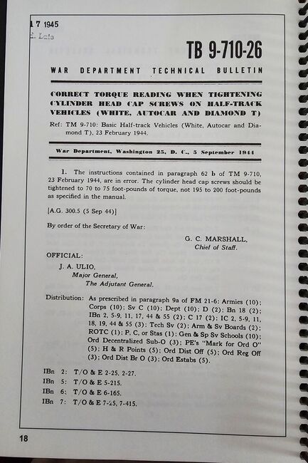

I had someone today ask me a question about the head bolt specifications for a White engine. The specifications in the manual are wrong!! The max head torque is 75 foot-pounds. Just wanted to pass the correct info along to help save your engine block.

My 1967 motors repair manual lists the head bolt torque at 105-110 for the civilian version of this engine and that is what I used.
