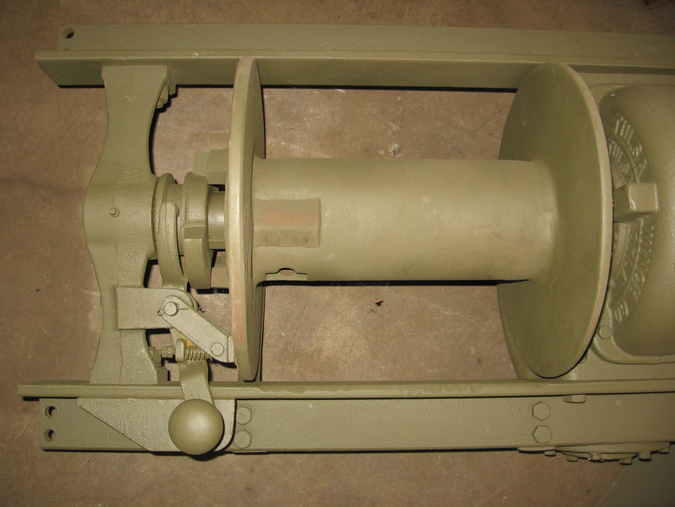

Hi all,
first time posting, proud new owner of a M16 in fair but running shape. working first on the winch , which came as a bunch of parts. The worm assembly looks to be the proper Tulsa 18G with a spacing of 13.5 inches between the mounts. However, the drum is about 14 1/2 and the end bracket is also 14 1/2 and has one mounting screw vice the two shown for the 18 G. the only other unusual thing is that the cable attachment "U" bolt goes on the clutch side of the drum while the 18G goes on the worm side of the Drum. I'm thinking of using it temporarily by just mounting 1/2 inch spacers on eash side of the worm to allow a 14 1/2 spacing between the cross mounts. Anyone familiar with this situation. Included a few pictures of moving day. I'll look for numbers next and addit to the registry.

welcome to the group
thats a good looking halftrack. it looks like an M16A2 because it has the modified shovel bracket.
the correct winch spacing is 13.5 inches so you do have something different going on there.
here are some pics of the original winch.
http://www.surfacezero.com/g503/data/3760/IMG_17211.JPG
http://www.surfacezero.com/g503/data/3760/IMG_17232.JPG

I went to the shop today and measured up all my winches. I have an 18H in my halftrack and two 18G's that need restoring (these are for sale if interested). This is what I found.
The inside casting to the outer supporting arm, width, is the same for all three and is 16-3/4". The length of the arms on all three is 13-1/2". The differences I found is in the drum. All three are different. The 18H has the thickest side flange at 1/2" and the cable mounts to the side. Both 18G's the flange is around 1/4" with the cable mounting inside the drum. See photos below.
18H winch
18G winch A
18G winch B
Each of the 18G winches is for sale for $500 as is. I can get the correct sides made for an additional cost as with other parts or you can do it your self. Just PM me if interested.

Here are some more pictures, note the end bracket bearing is on the center line with the bolts , unlike the the picture you posted above that has the end bracket with the shaft center line slightly above the mounting bolts.( a slight upward bend in the middle of the end bracket) it also has an extra boss for the actuating lever pivot and the shaft hole goes straight through. wonder what it was from??.
after measuring, I think the 14 inch drum will work fine with only a 1/4 inch shim on each side of the worm end and if I come up with a proper end bracket. But just buying a proper used winch is looking like the better bet.

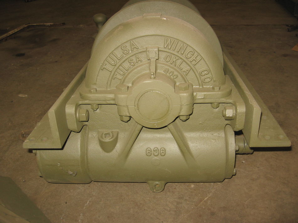

Are you sure you have an 18G winch? I've never seen that style of end brave before. Can you post photos of the rest of the winch. Maybe you have a different brand winch. The Tulsa winch has a square pad on top of the gear housing with the model number stamped in it...
This one is stamped 18 H
and on the side of the housing should say Tulsa Winch Co.

June 12, 2014, 11:44:27 AM »
here are some pictures. the worm section is indeed 18G , and is stamped as such on the pad as you showed. the drum has thick side walls , about 1/2 inch I'd say. note there are two places to attach cable so you could wind it either way. The drum pictures you posted only had one attachment point rather than two attachment points.......do you think it is a Tulsa drum? the shafts are the same size.
