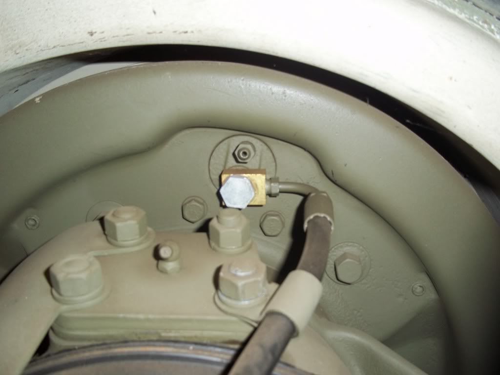

Hey Steve,
Here is how I adapted M35 front wheel cylinders to the HT. The custom brake hose connects on the side through the brass block and banjo bolt. I was unable to adapt a hose that connected directly to the wheel cylinder, yeah, I know its not original.
I was able to find original front and rear brake shoe linings from Rod Shaver (?). Our local NAPA sent the shoes and linings out for assembly, cost around $15 a shoe.
Karl
