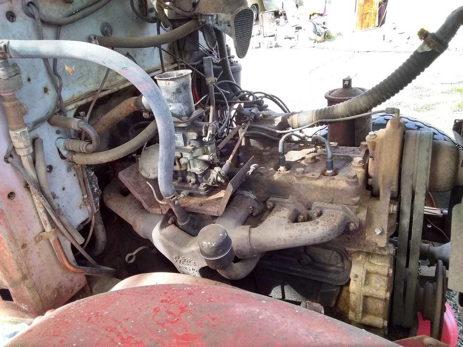

Hello all. I'm thinking of making a carburetor heat shield for my halftrack. I'm having some vapor lock problems with my halftrack. I've tried EVERYTHING. I am hoping a heat shield will do the trick. Has anyone done this already? Does it help? please post some photos if you have. Greatly appreciated. I did find a photo of a 1948 White fire truck and it has a heat shield in place. What do you guys think?

Due to our crappy California gas, vapor locking is a major problem with my track.  A few years ago I built a heat shield and meant to post it but I lost my camera.  Found my camera so here are the pics and long term results.
The carb sits right on top of the exhaust manifold.  When you shut the engine down, the carb gets heat soaked so the gas gets boiled out of the carb.  The gas spills into the intake manifold and floods the engine.  To start it up, you have to crank for a long time with the throttle open to clear the excess gas.
McMaster Carr sells sheet stainless steel that is mirror polished on one side.  I bought a sheet and formed the sides up.  Then I machined the sheet for all the required holes.  I installed the shield with the shiny side down, so that it reflects the heat.  On the top side, I used a fabric insulation material and covered it with metallic tape.  This has made a huge difference, but not completely cured the problem.  It will never be completely cured because Calif gas vaporizes so easily that it boils at a low temperature.
One more change that would make a big difference would be to install a second phenolic block between the carb and the shield.  You have to leave the original block between the manifold and the shield to give clearance, so the carb is mounted against the hot shield.  If you put another block between the card and the shield it would help keep more heat out of the carb.  I didn't do it because you would need to use longer carb studs.  No way I'm going to try to remove carb studs after they've been baked for 75 years.
