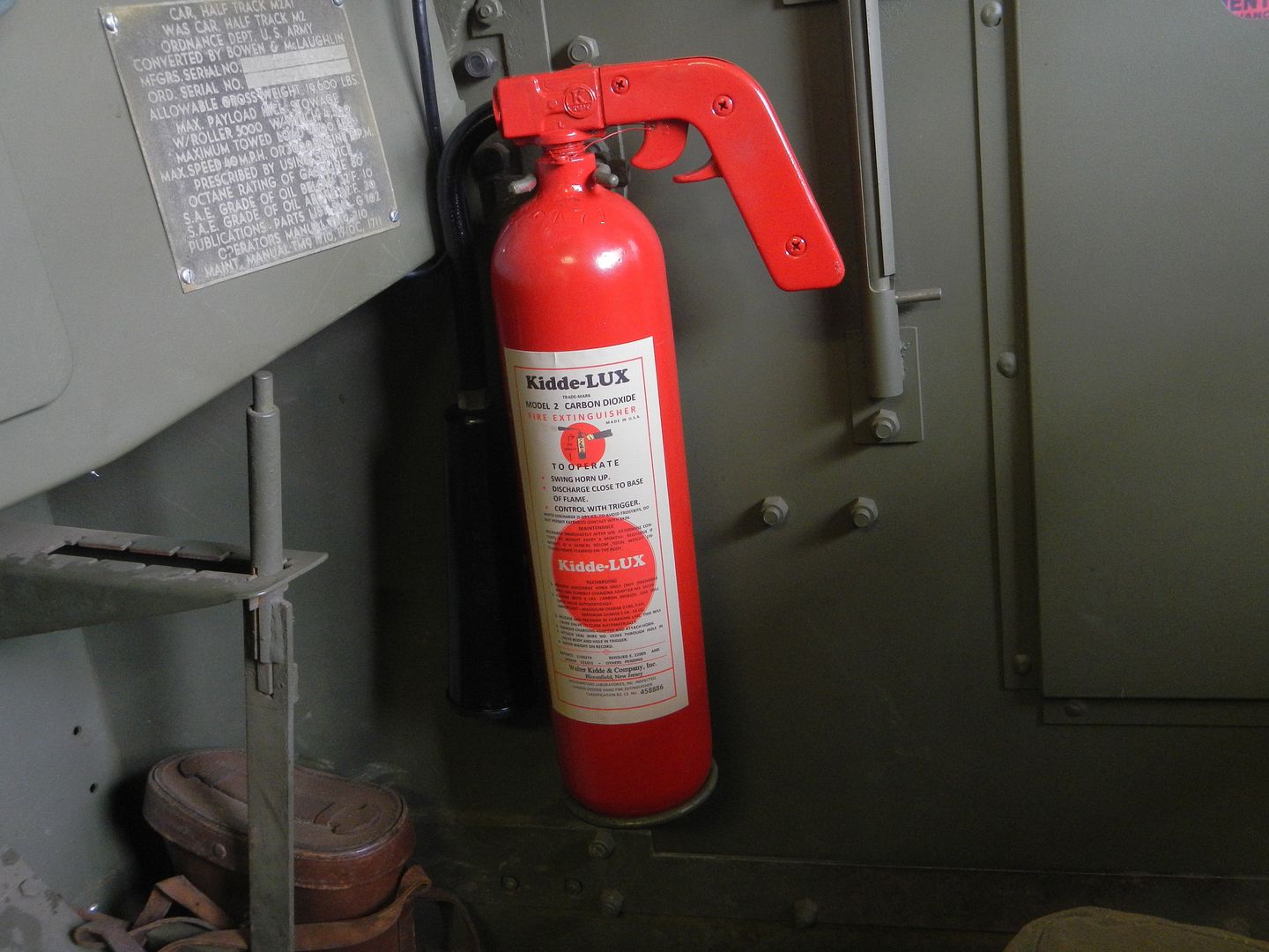

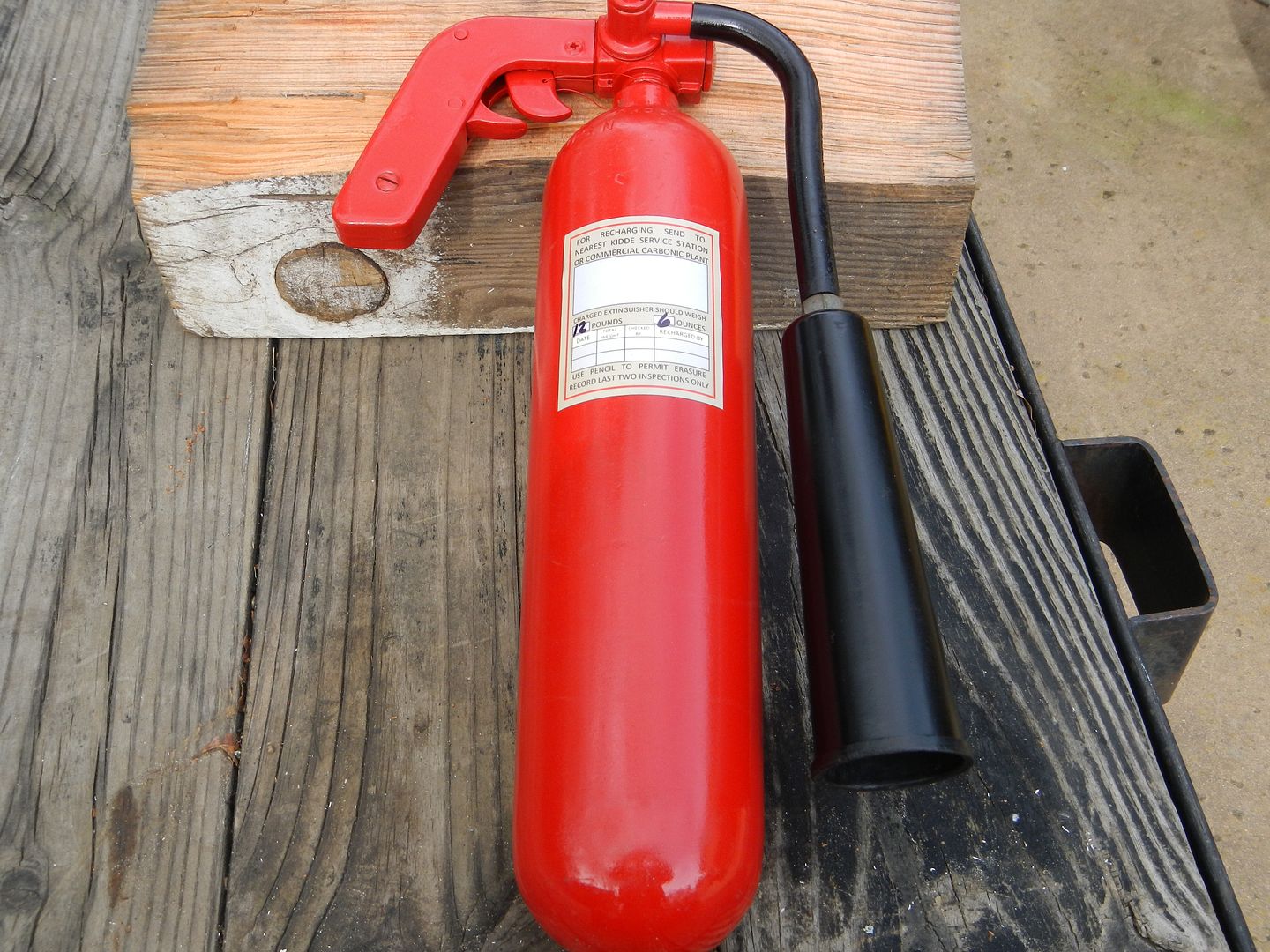

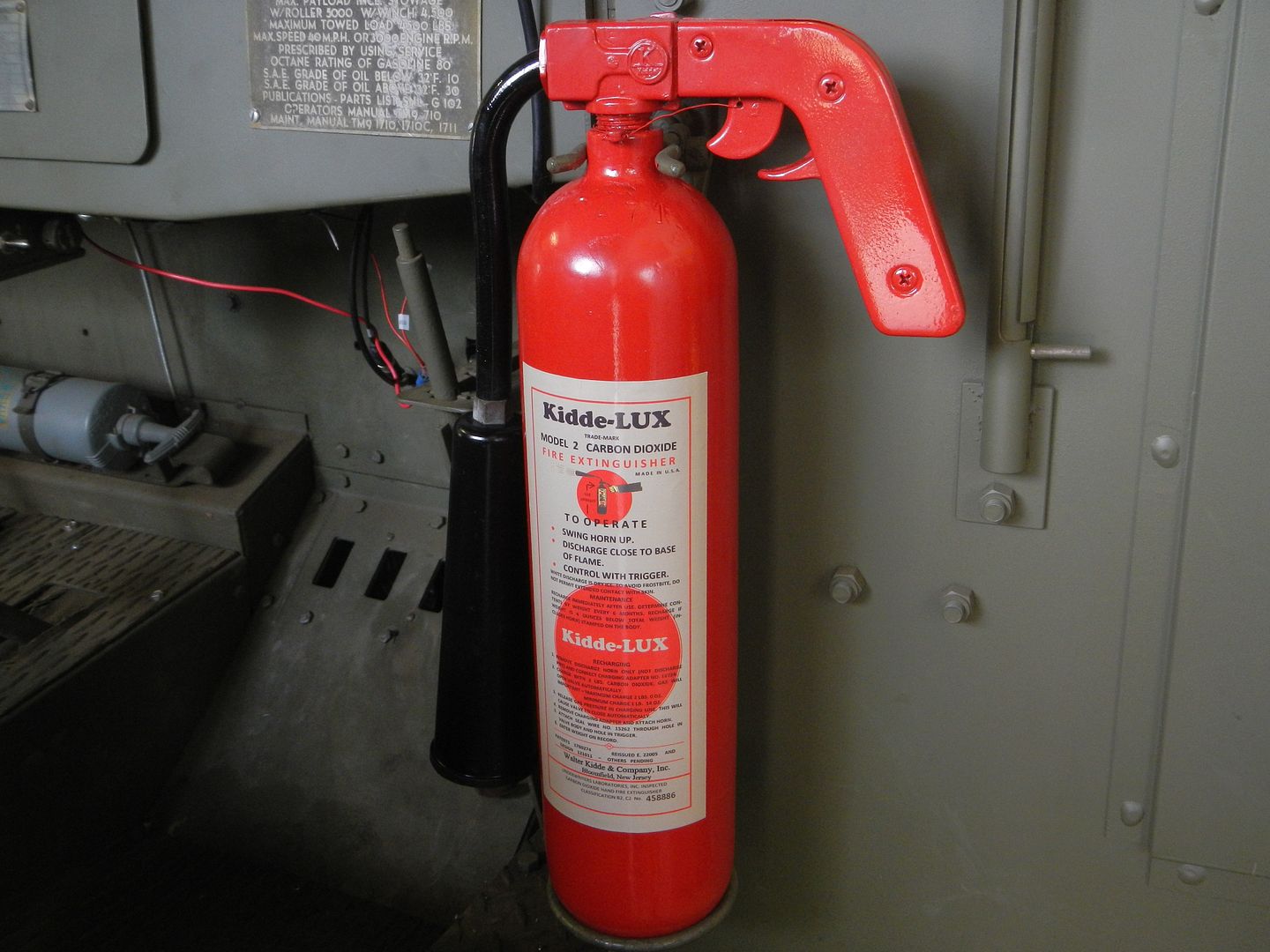

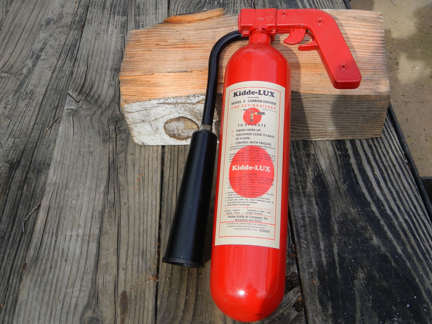

My latest Project - Fire Extinguisher restoration.
I got a slight wrinkle in the decal that I could not get out, but other than that I was happy with the result.   I decided to stay with red rather than OD.  There seems to be a debate on the proper original color but I thought it just seemed right to have the fire extinguisher red plus it adds a little more color to the inside of the track  ;)

I want one,  Looks great.

Nice job Tom...I agree with you on the color choice.

Looks great Tom. Is that the decal I sent you? Where did you get the one on the back? Is yours charged? I had no problem getting mine charged.
RocnTJ
  • Posts: 103
Re: M2A1 Restoration
« Reply #139 on: March 02, 2016, 09:32:17 AM »
Thanks guys.  No I made the decals myself from another co2 extinguisher I had.  I used your decal to scan the little hand holding the extinguisher picture then photo shopped it in.   I have some extras that I can give to you.

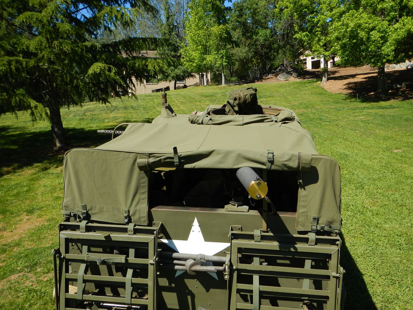

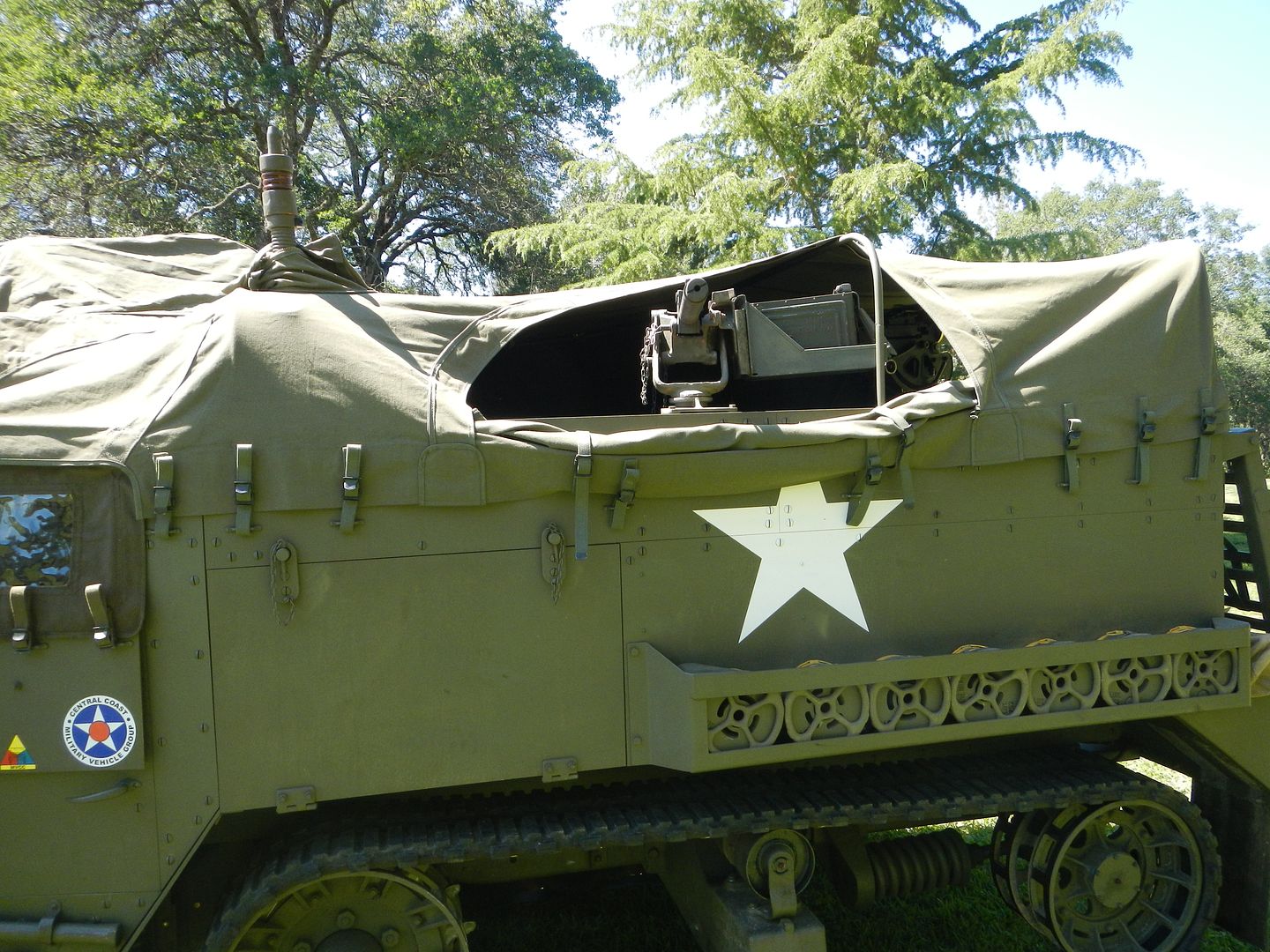

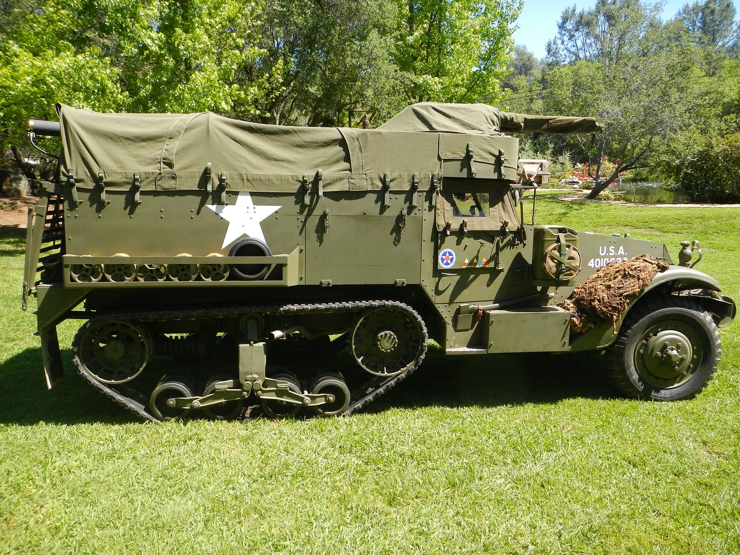

New Canvas Top.
The last big missing piece in my halftrack restoration was the canvas top.  I had contacted all of the major canvas suppliers in the US and none of them were interested in making a top for an M2-A1 halftrack.  Generally they did not want to deal with the pulpit as apparently there are several different versions of pulpits in the halftrack community.
I then turned my search to the UK which apparently has several military canvas manufacturers.    I first contacted John and Mary Worthing who had previously supplied a very nice canvas cover for my Ben Hur Trailer.   They told me that they did not do halftrack canvas.  Next I contacted Jim Clark at Allied Forces Canvas.   Their website is
http://www.milweb.net/go/alliedforces/
I e-mailed Jim and he said that they indeed did produce M2A1 canvas tops.  He thought they were about the only canvas supplier that had the pattern for the M2A1.     It took me several months of waiting to final get my top into production,  apparently they have a large backlog of orders.    Once they started working on my top Jim had me confirm all of the footmen loop locations as well as the antenna location to ensure that the top would fit properly.  Our goal was to have the top ready for the Tower Park event which I planned to show my halftrack.  Unfortunately the top arrived the day after I moved the halftrack to Tower Park, but I was able to drive home and pick it up and have it on the halftrack in time for Friday's heavy rains.
The following are some pictures of the top:

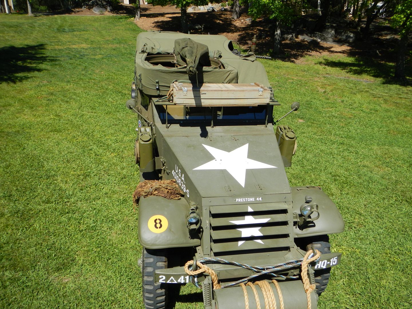

Here is a side view of the top installed on the halftrack.   The side windows are NOS from David Yamulla

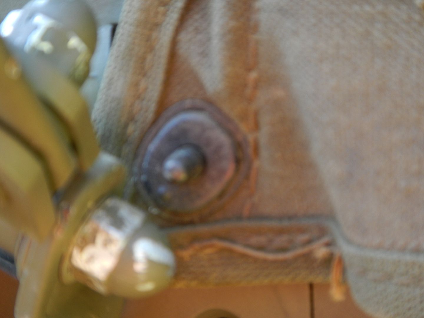

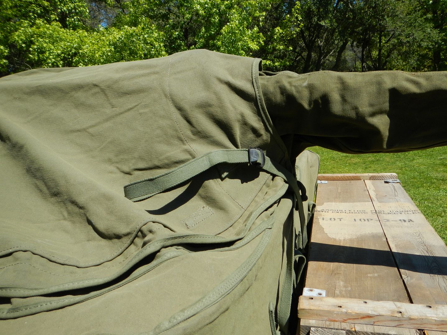

Here is a close up showing how the straps attach to the footman loops.
Here is a close-up showing how the top fits around the pulpit.
Here is a close-up showing how the window canvas connects to the lift-the-dot connector mounted in the side armor just ahead of the doors.   It was a challenge getting the canvas behind the mirrors and onto the pin but there is room to make it work.  If you are installing mirrors on your track you need to make sure there is clearance for the window canvas if you plan on using it.

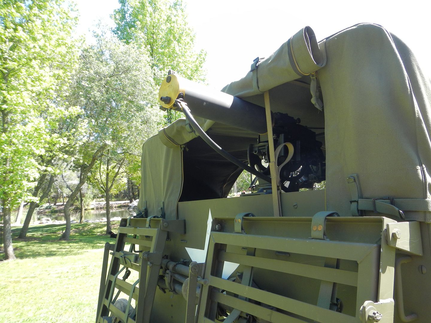

Here is a picture with the side rear window unzipped and rolled up.   Although it would be possible to use the guns with the top installed it would be challenging to get a good aim as there is very little clearance over the top of the gun.

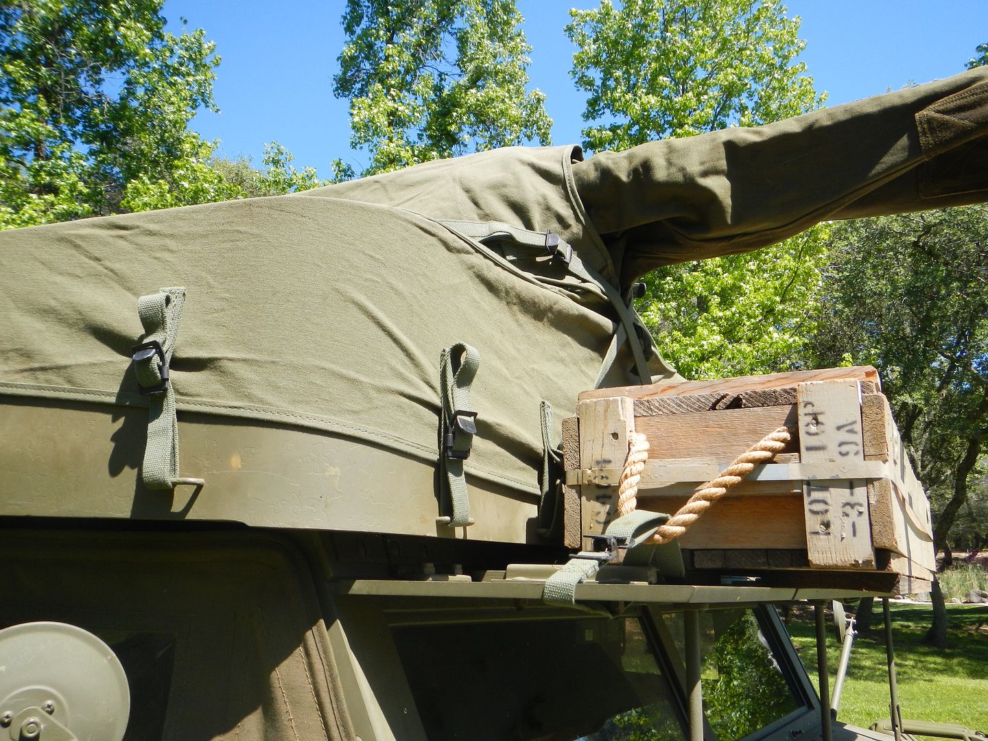

Here is a shot of the rear window.   The vertical strap in the picture is the strap that runs from a loop on the back armor to a loop on the back of the windshield.   There are two of these straps that help support the top between the bows.   I have a set of these straps designed for an M2 and I need to get the shorter strap for the right side which connects to a footman loop on the back of the pulpit.
Here is an overhead view of the canvas top.

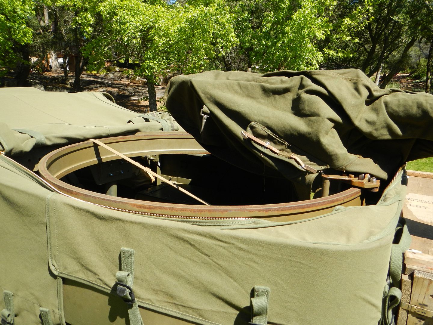

Two of the attachment straps at the front of the pulpit are longer than the rest to come up and secure the cover around the 50 Cal machine gun.   I have discussed the length of these straps with Jim Clark and it appears that they are too long.   I will probably shorten the length of these straps and put a new metal ends on them.
Here is an overhead shot showing the pulpit canvas rolled back.    This allows the use of the 50 cal with the top installed.  Many of the WW2 pictures show this cover rolled back with men manning the 50 cal.
Here is a close-up of the pulpit with the cover open.   As discussed previously the strap running across the pulpit should fasten to a footmen loop at the back of the pulpit.  I need to get a shorter strap and install a footman loop on the back of the pulpit.

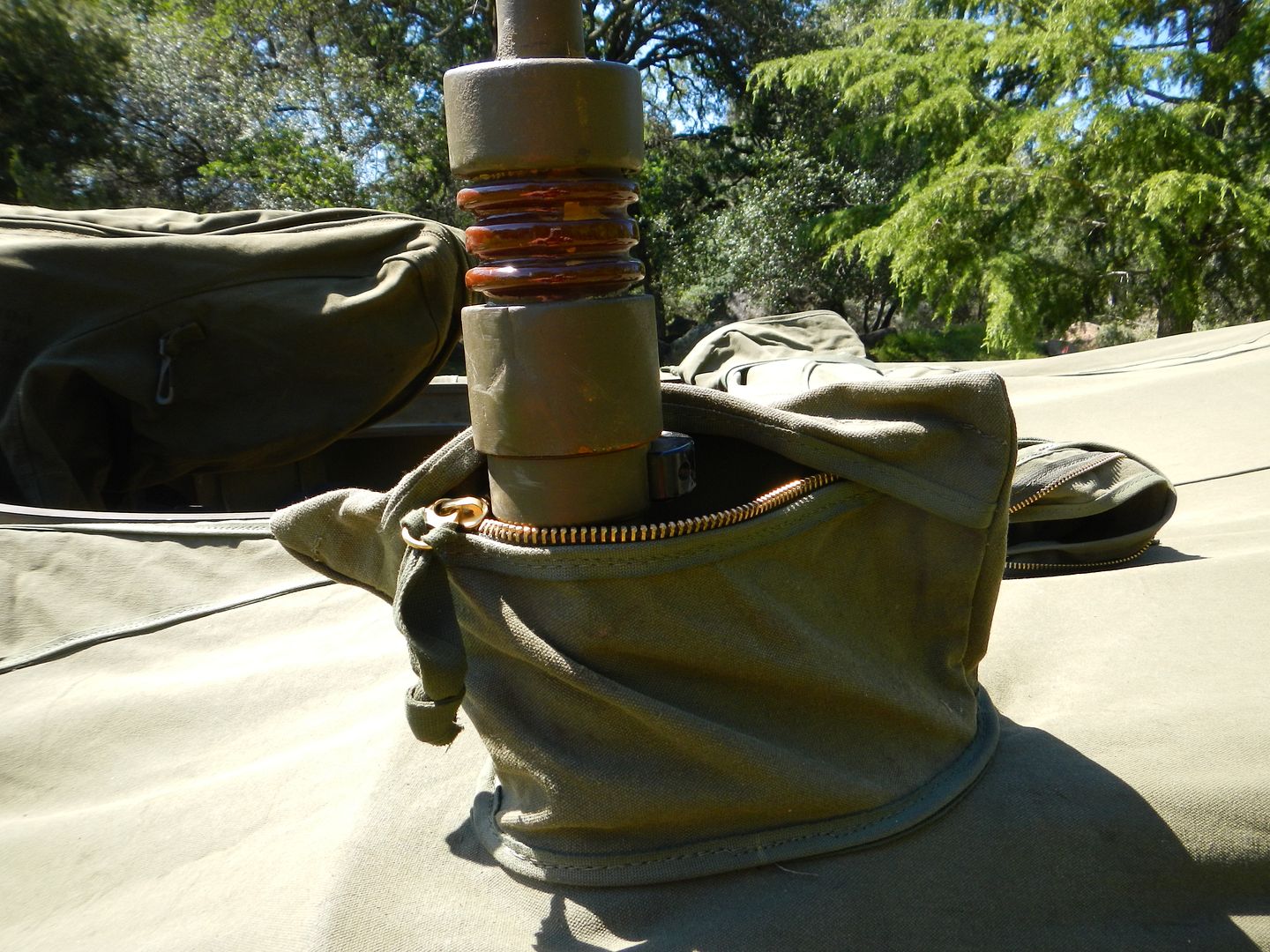

Here is a close-up of the pocket for the radio antenna.   This pocket is not high enough to cover the antenna base that I currently have installed.    I am talking to Jim Clark about making a taller antenna pocket that would cover the antenna base.   This is the one measurement that we did not verify.      The antenna pocket is zippered to allow the installation of the antenna with the top installed as was the case with the original tops.

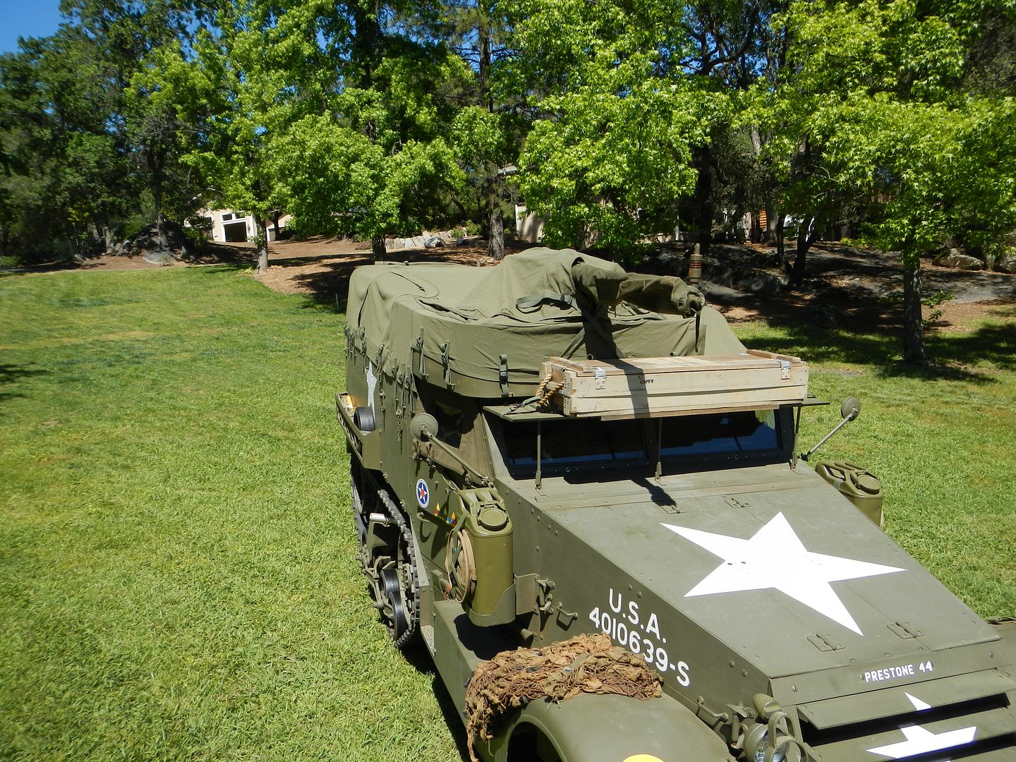

Here is an overhead shot from the rear.
Overall I am very happy with the fit and finish of the top.   It is a very close reproduction of the original tops produced for the M2A1 halftracks.   It is very high quality and besides the antenna pocket every thing fit perfectly.   I should get many years of use out of this canvas top.    Price was right on this top also - a little over $2000 delivered to my doorstep.     I am just about ready to call this project complete and start looking for my next one.    As mentioned previously it will not be another halftrack.   One halftrack restoration is enough for any sane person  ;)
